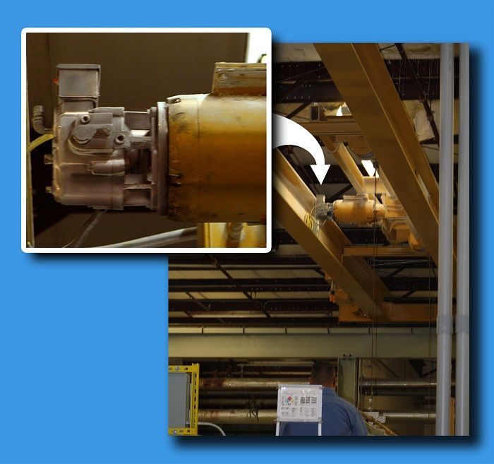

Force Control Industries presents a maintenance-free, no-adjustment crane brake that virtually eliminates crane downtime as well as the need to perform maintenance and adjustment at height. The MagnaShear motor brake employs oil shear technology, providing longer service life in demanding applications like the frequent start/stop cycles seen on cranes, hoists, and winches. Proven oil shear technology transmits torque between lubricated surfaces – thereby eliminating wear on friction surfaces. A patented fluid recirculation system dissipates heat – eliminating heat build-up which is the most common problem in dry braking systems. Elimination of the wear significantly increases service life and virtually eliminates adjustment which also elongates maintenance intervals. MagnaShear Oil Shear Crane Brakes are proven in demanding applications like anodizing plants, foundries, critical-line manufacturing plants, and more.
