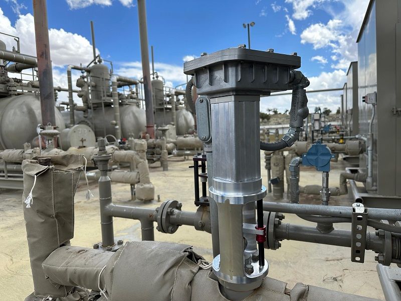

New Tritex EVA electric valve actuator achieves CSA Class1, Division 2 Hazardous Location certification following successful field testing
Curtiss-Wright’s Actuation Division has announced that its new Exlar Tritex EVA electric valve actuator has achieved CSA Class 1, Division 2 (C1D2) Hazardous Location certification. It also outperformed American Oil & Gas producers’ expectations for rugged field test operations in Texas, Oklahoma, and New Mexico. The Tritex EVA answers the demand for an efficient, high-speed solution while meeting the Methane Emissions Reduction Program (MERP) and Quad-O zero-emissions regulations in the oil and gas industry.
“Based on nearly 30 years of experience in oil and gas valve actuation, our Tritex EVA is well positioned to meet the needs of the growing market,” said Phil Bowker, vice president/senior general manager at Curtiss-Wright Actuation Division. “With this innovation, producers can meet today’s strict regulations without compromising speed or performance when switching from pneumatic to electric.”
The Tritex EVA is environmentally friendly and efficient with a powerful, compact system integrating a servo drive, motor, and roller screw actuator to achieve extreme life, speed, and accuracy. Combining the simplified actuation system with Modbus RTU communications enables producers to have remote operation and monitoring - all with less components when compared with pneumatic systems.The electric Tritex EVA has been under field test throughout 2023. The field trial units remain successfully in service, proving the ruggedness of this new technology.
