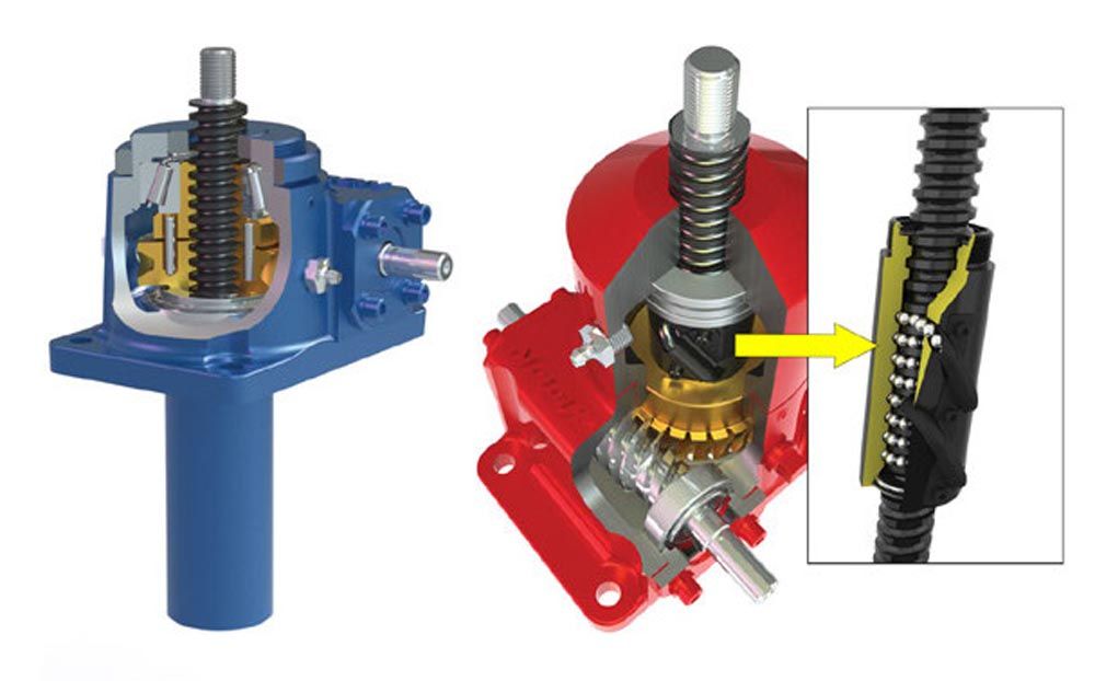

The high-friction operation of the machine screw within a jack requires about twice as much input torque, so a larger motor would also be required. In applications in which either multiple machine or ball screw jacks are configured in a system, a single motor could drive all jacks, further improving energy efficiency. A scissor lift, for example, might deploy jacks driving its left and right sides with a connecting shaft in between. One motor can drive both jacks (Figure 3).
Figure 3. The two screw jacks on this scissor lift can work with a single motor. If the duty cycle was less than 25 percent, they could operate with a machine screw jack, which might counter the higher energy consumption.

Axial pressure on the lift shaft or travel nut can push it backward, especially if a brake or other holding mechanism in a vertical orientation fails or the system loses power. In such cases, the relative inefficiency and high friction potential of machine screws give them an advantage over ball screws. Depending on the gear ratio and efficiency of the lift shaft, machine screw jacks can be considered self-locking.
The high efficiency of ball screws used in vertical configurations can cause them to slide backward easily if power goes down. For that reason, ball screw jacks must be outfitted with a brake or other holding mechanism, adding cost and complexity.

The engaged frictional thread of the machine screw jack makes it difficult to predict its life cycle. Ball screw life cycle, however, can be calculated based on measurable inefficiencies that contribute to fatigue of the ball bearings under a dynamic load. Known as the L10 standard, this calculation estimates the number of revolutions or hours at a given constant speed that 90 percent of a screw system’s group of bearings will complete or exceed before failure. It is impossible to predict the life of machine screws, so if end users need to predict the life of their screw jacks, the ball type is the only option.
