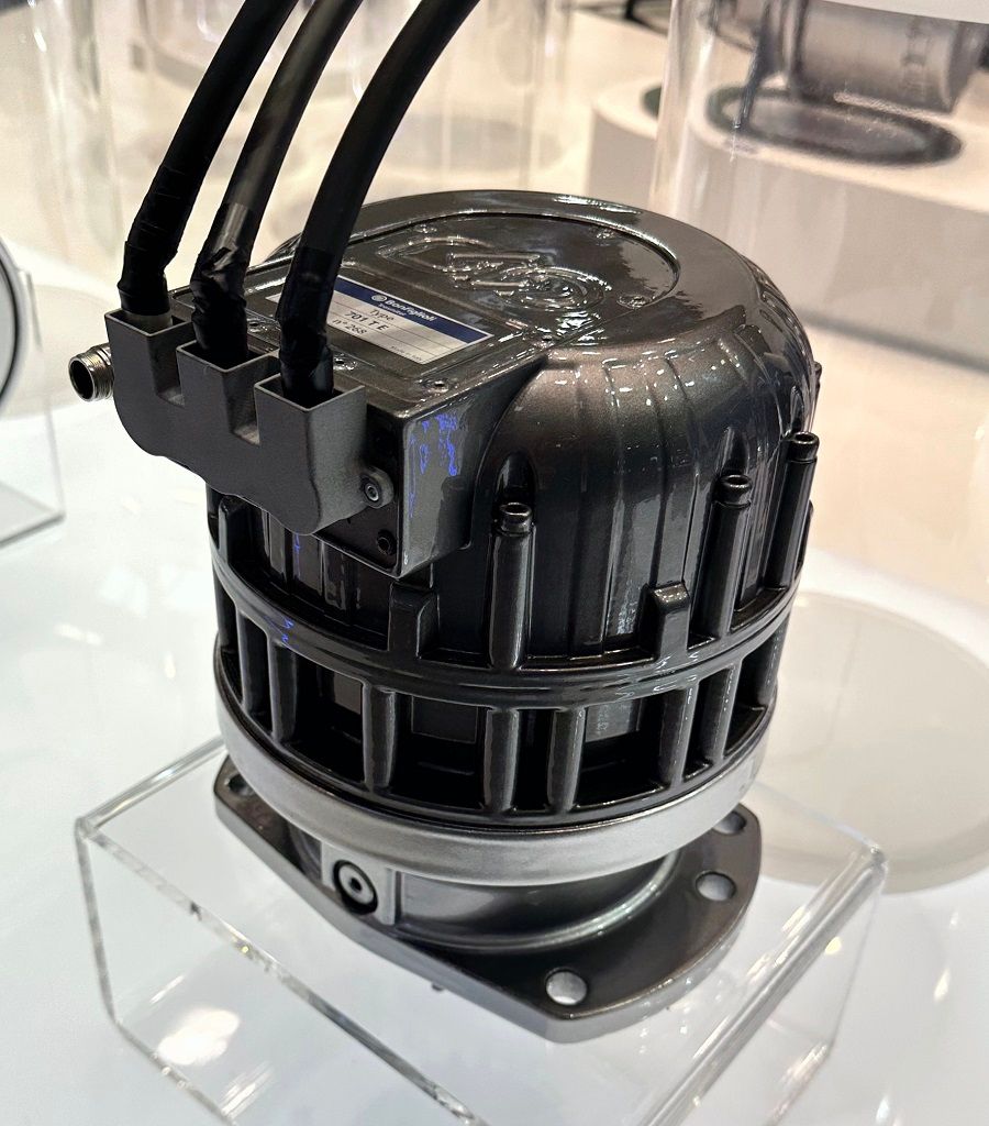

The new electric drive series itself is scalable in three diameters, each with several lengths of the electric motor. The concept thus allows a power range of 4 to 150 kilowatts for the series. With the motor diameter of 230 millimeters presented at bauma 2022, three lengths with 4, 7.5 and 15 kilowatts are available. Further diameter/length combinations are in preparation. In other words: The electric drives are suitable for very different performance requirements and installation conditions.
The electric drives, which can be used as travel and swing drives, are designed in principle in such a way that, like their hydraulic models, they have all the technical necessities and properties. The electric motor in its robust housing is air-cooled and corresponds to protection class IP67. The core of the drive, the permanent magnet motor itself, is maintenance-free. It is equipped with temperature and speed sensors. A single or multi-stage planetary gear is flanged directly to it, which is defined according to the requirements of the machine manufacturer. Its maintenance intervals are long, and maintenance itself is very easy thanks to the smart design.
